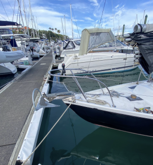

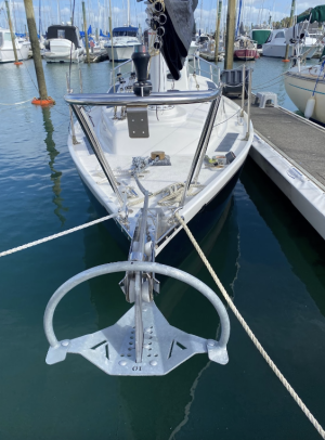

Real world use. I used a Viking 10 on 26', 6,000lb yacht in 30 knot sustained, 50 knot gusst gale in a cove in NZ a couple years ago, that lasted 5 days. The Viking didn't budge an inch. That doesn't mean I am saying it is better than other new age anchors, which might have worked just as well anchored in the same sustained gale - I am just advising what happened to me. I would also say the 40 metres of all chain with a 3 metre nylon snubber obviously also helped. I have since sold the boat and the Viking along with it, and have heard back no issues with the anchor by the new owner.
noelex
2 Jul 2005
4,793
Thanks for the report. It is always valuable to hear how anchors are performing in the real world.
The Viking 10 is recomended for boats from 30-40 feet and displacements up to 27,000 lbs. I am pleased to see you very sensibly ignored the overly optimistic sizing tables published by the manufacturer (y).
One of the difficulties experienced with Viking anchors is that the designer has placed the shank fluke connection close to the head of the anchor, which gives the fluke a long overhang. I think this is part of the reason very small anchors are recommended. It is difficult on many boats to fit anchors of a sensible size.
Did you have any trouble fitting the 10 kg anchor on the bow of a 26 foot yacht?
JRCO26
2 Mar 2019
41
Kia ora, noelex,
No, but that may be more to do with the way I attached my longish anchor roller, which was also welded to a V plate, and then of course well bolted down. See photo
