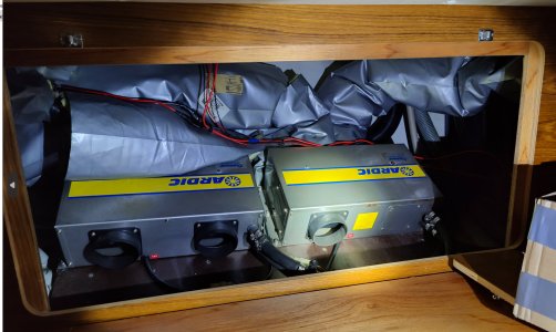

Most of the Nimbus I am looking at have Ardic hot air diesel heating. I can't find a good word about these on the internet and it sounds like Eber took them over and phased them out. Am I correct that they are rubbish and can you slot a modern Eber unit in using the same ducting, skin fittings and other bits?
Wondering if anybody here would now answer for this one:
- I have 2 x 1012 WA Ardics side by side, one for Defroster and another one for cabin heating
- These units are actually coupled together i.e. engine heated cooling water flows thru both of them
- I will remove, replace both of these Ardics -> the plan
Problem: I do not know which 16mm cooling hose brings IN water and which hose is used for Return flow to engine direction
= Ardic installation instructions do not define In / out water flow direction or unit chassis inlet / outlet pipe to be used
When I look brand new heat exchange units, there is clearly In / out water flow defined in installation manual
Does anybody know this ..

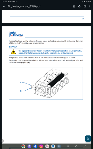

It doesn't matter on the Ardic as it's a crossflow heat exchanger, I'd be surprised if it is different with any replacement. Could you post the diagram for the replacement? What's wrong with the Ardic units, there's not much to them, just a heat exchanger and a fan?

for example this isotherm air heater manual defines in out water flow
