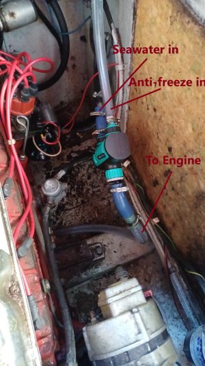

Pipes are all connected .. bit Heath Robinson at first - to prove concept ... valve unit is not strapped to engine bay side yet ,,,
Basically the idea is :
For normal use - Seawater IN valve is open, Antifreeze IN valve is closed. This then allows engine to draw raw water ...
When lifting out for winter - I can now close Seawater IN and open Antifreeze IN ... I have a bucket with pipe fitting in the bottom that I then mate to that pipe and pour AF in while engines running.
Previously I had to lift boat out of water first as the Seawater IN pipe was jointed to Engine In pipe .. disconnect would have allowed boat to flood as joint was in the bilges.
Later I am planning to design a better looking unit that also has pipe unions that are all correct size !

Why not adapt the antifreeze inlet pipe to act as an emergency bilge suction pipe.
Will those plastic pipe unions have enough flow rate.
I fitted similar to 130hp turbo inter coolerd diesel but used 1inch flow valves.
At present its KISS .....
Obviously as the system evolves - ideas will pop up .. maybe used .. maybe not ...

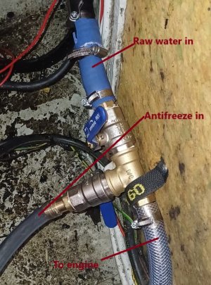

OK ... metal valves / pipe spigots / T piece bought ... all to reduce the number of joints and to have what I feel a more safe setup than a plastic valve unit. I'm sure the plastic unit is good .. but its that nagging little voice in back of head ...
I do intend at some stage to venture out of the river to the Baltic ... calm day of course ! ... so feeling safe is important.
OK - valves temporary fitted ... need to fit washers etc to get valve handles correct place before permaent mount .. I am not a fan of teflon tape and just turn valve to position ...
Before anyone comments on the fittings ... river is freshwater and even Baltic is only brackish at best ... so SW corrosion is negligible ...

My present setup .... boat launched ... tested ... all good.
