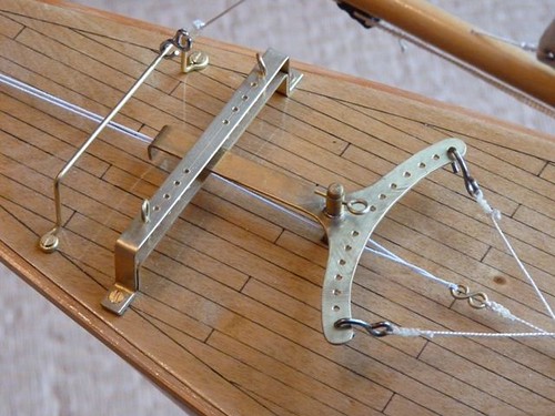

Years ago, a standard method of steering model yachts was "Braine Gear Steering". the main-boom was attached to the rudder by cross-over sheets attached to a multi-hole quadrant. The various holes gave selectable mechanical advantage. The quadrant was centralised by a rubber band. The system was quite effective in countering variations in wind strength to maintain course. Wind vane gear later became more popular, then R/C.
here it is
