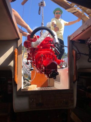

I'm glad I'm not in a hurry.View attachment 169480
That takes me back.
I notice that it’s a very different high rise exhaust to the one on our Beta.
And they are putting it in back to front!
