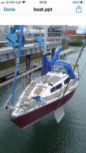

I designed and built this boat, taking me over 5 years. I first launched it in 1986 and named it Devil`s Dream. I used it extensively in the Irish Sea, sailing to both N. Ireland and the republic, N. Wales, Scotland and nany trips ti the IOM. I constructed the split-pattern bilge keels in plywood and they were cast by Henry Irons foundry in Cornwall. They weigh 560kg each. Still have the construction drawings.I can confirm that it is a very capable craft and has got me through more than one full gale.

Checked my records and it was first launched off the RIBC slip at the end of April 1987, not 1986. Bert Jackson Jnr. surveyed it and gave it a really good report.
Extra info:- All laminated with 2 layers of csm, 3/8" end-grain balsa sandwich and 2 inner layers of csm. This gave a stiff and light structure. Exra glass & resin of course at stress areas. The bilge stringers are 14ft long, epoxy laminated with 3 layers of 3/8"marine ply, through bulkheads to effectively support the keels. I can supply more info about the keel attachment bolts and still have some spares. You can contact me on Preston 914042.

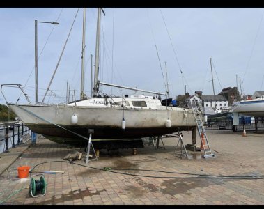

Ah that fills me with confidence 😂 in all fairness I have a very extensive history of the boat and mine was built in Liverpool in 1985 was sailing in Liverpool sailing club till 2001 and then was restored after the first owner sadly passed way and brought over to the Isle of Man . It then had the same owner for 10 years who seemed to look after it and then it has sat in peel harbour for the last 14 years untouched.I don’t think it was this one that sank

Also some pictures of my project boat ameera

Definitely not the one from Barrow which was called JONMELHAY, abbreviated from his kids names.
I built mine with deep bilge keels and it was named Devil's Dream, renamed after I sold it to Mischief Maker. It is berthed in RIBC at Barrow-in-Furness and is still in great condition and has recently had a positive marine survey. I sailed it into Peel, IOM, several times and have fond memories of my visits.
Hope you get Ameera restored and sailing again soon.

Thankyou very much ! I think this year is a write of but am hopeful that by this time next year I should be ready to go back in the water. How well do they sail ? And what force would u say they’re comfortable in ?

Sorry, just noticed your response. Mine sailed very well and survived a F8 gusting F10 from Chicken Rock to Barrow. Running with just a small sinstalled Anything up to a F6 it coped well with ease, but it all depends on the designed balance of the boat, the sail choice and competance of thecrewm.
The original drawings were for a fractional rig and fin keel, making them competative and they used to race in Holyhead.
The cockpit drains which I installed, discharging to the transom were very effective and I consider necessary.
