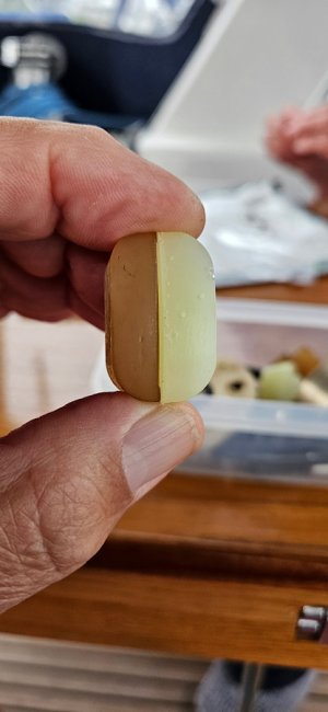

GEM43
6 Jul 2024
57
The Yanmar box is common on the GM range and yes it clunks into gear, but so does my mechanical PRM. Volvo boxes (at least on the saildrives) seem more refined. You don't say what make of propeller it is but the buffers on the Flexofold are there for a reason flexofold.com/folding-propellers/shaft-propellers/2-blade-shaft-folding-propeller and from what I can see other designs do not have these relying on metal to metal contact.
To that can I add that I’ve recently replaced the shock absorbers on my Flexofold. They were eight years old. The new ones are noticeably thicker than the old ones and they have definitely reduced the “bang” to a “thud” upon engagement.
