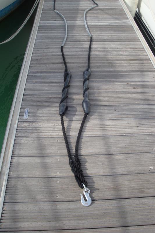

I think this is the kind of thing that is being suggested
We used to do this all the time to take the load off the windlass - remember that the windlass has a cone clutch - so I wouldn't want to spend the night at the mercy of just a clutch.
We have now fitted one of these:-
Which we use all the time,
But if there are people sleeping in the forward cabin, we usually stick the bridle with the chain lock on - to stop the chain rolling over the bow roller all night.[/QUOTE H yes that is what I want to do but how do you get the snubbers to the chain

I use a bridle,get some decent rope and splice in another to form a Y . Soft eyes on the top two ends go onto forward cleats and a thimble end on the bottom with a shackle pre attached to it to fix to the chain. Once all chain is deployed I just attach the shackle to the chain and let a bit more chain so the bridle takes the strain. I leave the bridle permanently attached to the cleats .

That's what I do in my current boat, even if she has an open bow roller, hence it's also possible to attach the hook directly by hand (as opposed to "fishing" for the chain with the line attached to the hook), and then release as much chain as necessary.
It does take a bit of practice, but what in a boat doesn't?
If for any reason you don't like that, here's an alternative - a bit more cumbersome possibly, but bullet proof.
That's what I had to use in my previous boat, whose pocket anchors chains came out of the hull way too low to use the previous method.
Firstly, attach the line to the chain with a carbine hook.
Then release the chain, letting the hook and the line slide inside the steel chute, together with the chain.
When the line reappears under the bow, just grab it with a boat hook, pull it onboard and secure it to a cleat - job done.
A further refinement is the use of two lines, both attached at the same carbine hook and eventually to the bow cleats on each side, but the method for passing them through the chute and recovering them with the boat hook remains the same.
Below are two pics showing this setup, which is essentially the same that Hurric showed above, but with no rubber snubbers on the lines, which imho are not worth bothering with, because with enough chain the catenary effect is as effective (if not more) in absorbing snatch loads.
But each to their own on that.
Yep - I agree with the concept but if you need to leave in a rush, you would need to undo the shackle.
Why not use a chain hook - really easy to use.
This is mine
