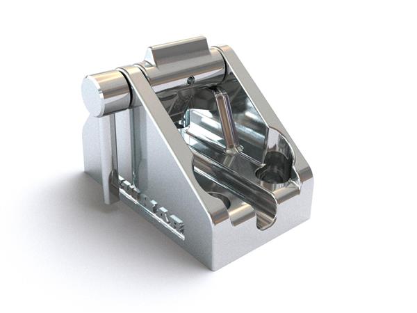

J, actually if you use either the hook I linked in post #4 or the one Hurric suggested, you don't need to release anything.
They just let go as soon as there's no tension on the chain anymore, so you can recover the chain and just leave the snubber hanging from the bow for as much as you need/like.

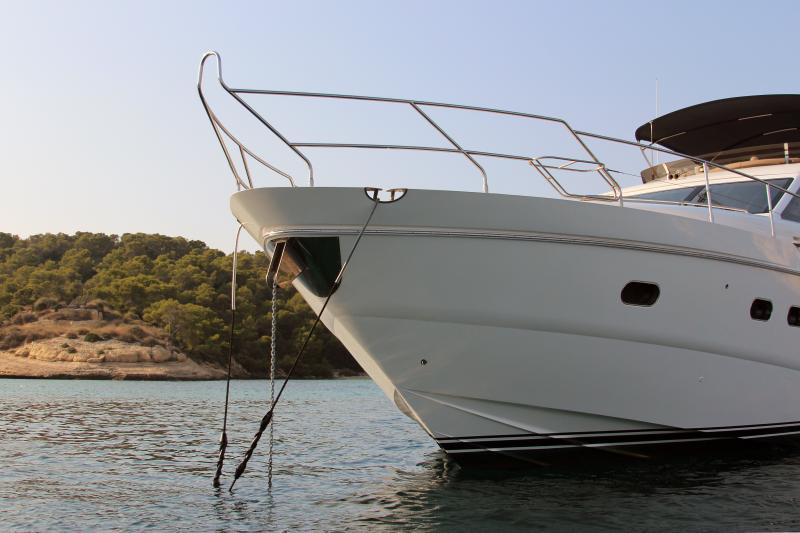

Btw, even with the carbine hook which I used in my previous boat (post #36), I did experiment recovering the chain with the hook and the lines still attached, because I also wondered about an emergency recover. And the winch pulled everything inside the chain locker, without batting an eye.
Though of course with a carbine hook you still must release the line(s) from the cleat(s) before winching in the chain.
I can see why you would struggle to attach any "form of hold" to the chain on your boat. With open bow rollers it's obviously easier.
You might try one of these things, which I think is what Hurricane suggested.
After attaching the line(s) to the round-ish ring, you can hang it from the bow and with some practice (and luck!) make it grab the chain.
Once done that, it's just a matter of securing the line/s to the bow cleat/s, while keeping the lines under tension, otherwise the thingie self-releases from the chain.

Thats the chain hook I use and its made by Osculati https://www.osculati.com/en/11004-m-000249/mooring-device-and-anchor-chain-gripper. It does fall off the chain very easily when you take tension off it but because of that it sometimes takes more than one go to attach it which can be a PITA as it often requires 2 people to fit it, one to locate the hook and the other to maintain tension on the bridle ropes

As the green one is a hook and it is not obvious it will release. The Deleted User one connects to the outside of the chain and basically has to fall off. ( as far as I can see )

This maybe a stupid question but in your 1st pic on post #36 I see you have twin anchor arraignment. The port side of the windlass has a gypsy for rope, what is the starboard side for?
Well spotted.
That windlass is a bit complicated because it's designed to handle two anchors independently, but with just one motor.
So, aside from the two brakes I previously mentioned (which are the round handles half visible at the bottom of the pic), there are also two clutches (round handles on the sides). This allows to use either port or stbd anchor, by playing with the brakes and clutches.
