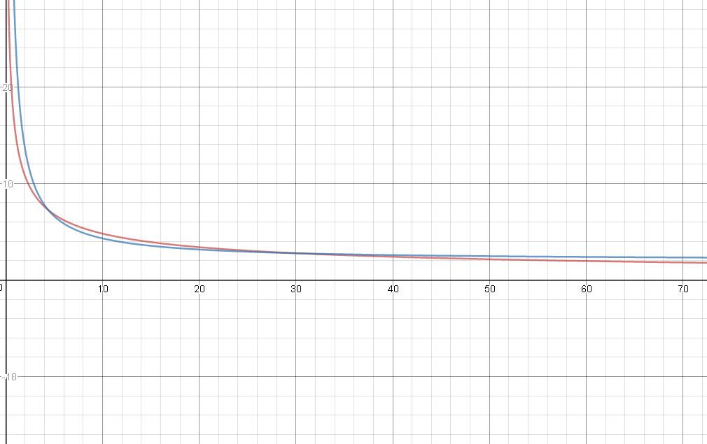

I think you will find it was YM, not PBO, unless the same person wrote to both mags. His suggestion was square root x 12 but of course this is nonsense, at 144 the anchor would not touch the bottom. My reply quoted 4:1, which is a reasonable compromise but I have anchored with as little as 2.5:1 and as much as 10:1.
This is 2 x Depth + 23m (red line) , which matches very well 10mm chain with a force of 230Kg(just lifting the last link off the seabed) . (the blue line, y axis is scope, x axis depth of water in metres)
https://www.desmos.com/calculator/lzjff8atpq
Been a while so I can't remember how the equation works, feel free to show its wrong :)

Similar to the scope required to just lift 10mm chain with 230kg and 2X+23m(easier to remember)
Lowest line on here..
2X+23m gets my vote, little to be gained with more than 8:1 in shallow water anyway (apart from feeling like you've done something :) ) so the very start of the graph can pretty much be ignored.
