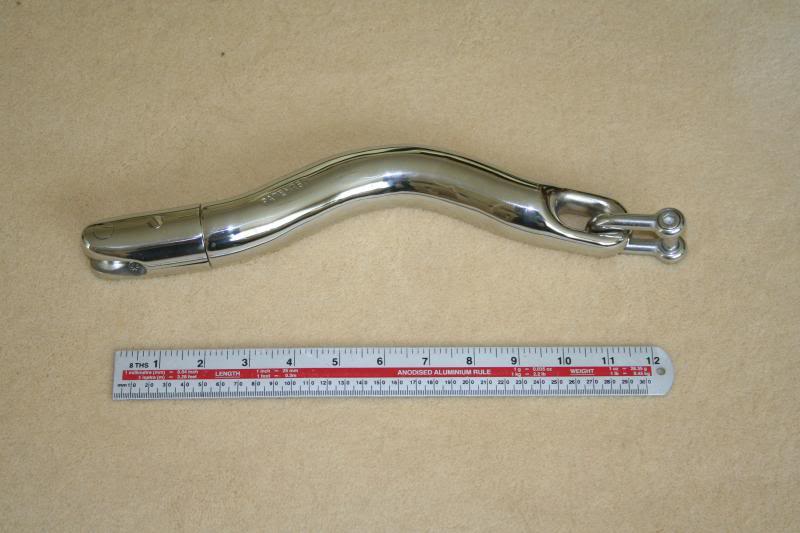

I'm sure fitting a banana swivel will work - it has to.
The swivel bit is on the chain end of the banana.
The banana itself is fixed to the anchor so that it can't swivel.
When the bent banana shape arrives on the roller, the anchor can't do anything but turn the correct way round.
Warning though.
You HAVE to use the correct shackle between the banana and the anchor.
We have had the banana get "locked" at 90 degrees to the anchor shaft with no way of recovering it.

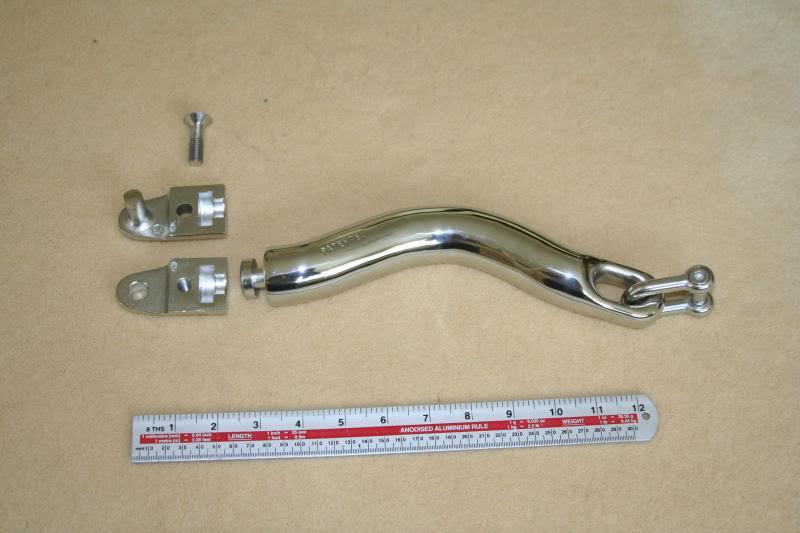

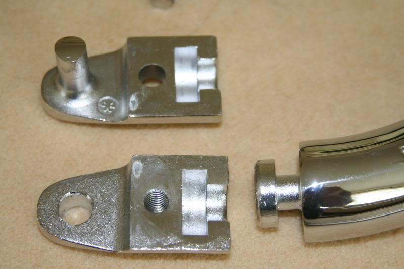

Here are some pics of the banana in detail:-
As said above, we don't use it any more - with our bigger chain and anchor but it does work.
Warning though.
Absolutely correct.
And even more important, avoid installing it the other way round, i.e. with the CHAIN attached to the shackle and the anchor on the other side.
I know this will sound as stating the obvious to yourself and anyone else who knows how the thing works, but believe it or not I'm aware of folks who complained that the banana only works half of the times, and then realized that it was installed upside down... :o :rolleyes:
Also in this sense, the Douglas Marine model is better, and practically fool proof, with no shackle at all.
PS: btw, if you abandoned the banana because you feared that it's too weak in proportion to your new chain/anchor, the Douglas one is available in larger sizes, for up to 180Kg anchors, no less!
