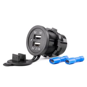

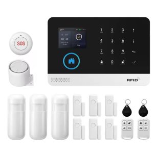

Hi
All so I'm planning to put a alarm system in my campervan and going to run it from the leisure battery. From a 12v 2x 5v usb socket. The alarm pannel runs on 5v and the siren 5v. I have pics attached on here also would it be safe to have it left on constantly from the 12v 2x 5v usb socket.

It isn't the voltage that matters - that's right, or it isn't, but the current. USB chargers, especially cheaper ones, tend to have a limited current output, and the rated current is often shared between the two sockets, so a twin socket 5 amp charger might only give 2.5a for each.
I was just wondering, if the siren draws too much power, there may not be enough left for the alarm, which might give problems. fredrussel's suggestion of a buck converter or two would overcome the problem - if it really is a problem.
I might buy one of those looks the safer option the one buck with the circuit board. I'd say the siren would run on 3v. So what fuse would I use for this buck
