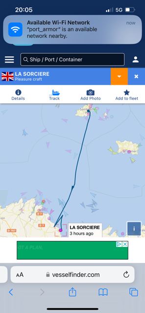

Chris CJ
30 Nov 2020
118
Thanks for all your comments , we had another interesting experience the other day where the track suddenly altered putting us on the beach and then correcting itself , as shown belowIMG_9119.png
wonkywinch
30 Jul 2018
2,031
Hamble, UK
Thanks for all your comments , we had another interesting experience the other day where the track suddenly altered putting us on the beach and then correcting itself , as shown belowView attachment 178431
I see this all the time, I think you just have to accept the limitations of the web based AIS trackers. The level of accuracy you see is directly proportional to how much you are paying for the service.
If you want accurate tracks of your own voyages, you're going to have to record them yourselves then overlay your gpx file on Google maps etc.
Relying on AIS pings interpreted by amateur receivers feeding a free service on the internet is a different type of data than your own HPS derived track with many more points of data saved.
