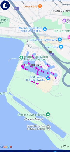

Why do so many people leave the ship's AIS continually transmitting? Even boats on the hard are transmitting. Why? Mine is switched off the minute we're not underway. I must be missing something?

But really what is the problem if people do leave their AIS on when in a marina?
P.S. ships do have their AIS on all the time including when in port.

@Momac leaving the units on just swamps the system and clutters up the mfd screen as you approach the marina / anchorage. Its even worse if you have the course lines shown.
My raymarine eS plotter could only handle a certain number of AIS contacts.

It seems to me the clutter aspect is really only a Solent issue . Maybe some other south coats areas also.
