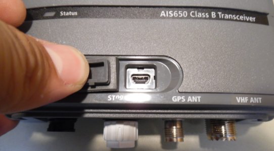

I’ll get on the boat this weekend to take a look at the AIS unit and see what cable and software I need to reprogram the name. My business is IT so should be easy to get done.
If it is the Raymarine AIS650 then bring your laptop and a “mini-USB” cable and you’ll probably be able to get it sorted straight away… all the downloads you need can be found here… AIS650 Software Download | Raymarine
