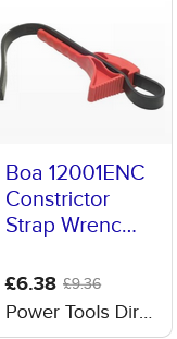

Hand tight is all I did. But a Boat Constrictor would do it. But don't overtighten it.
