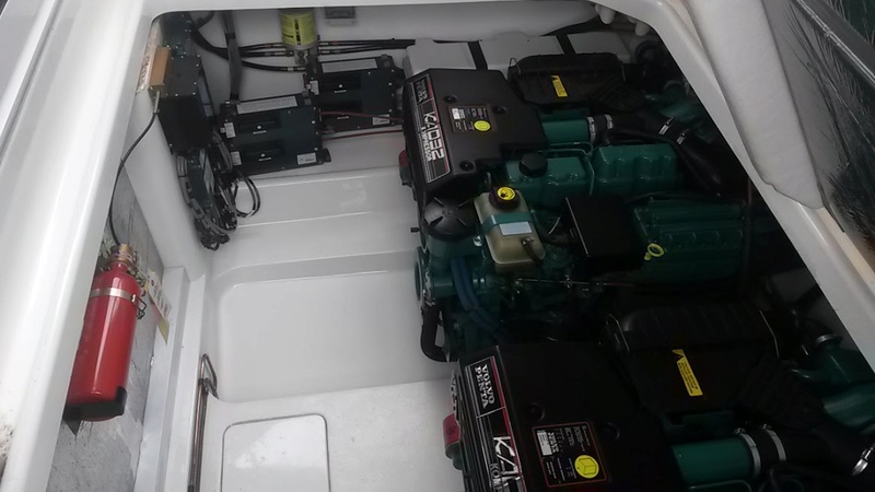

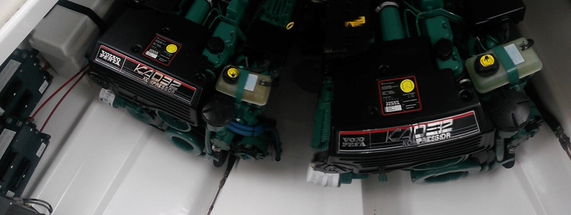

I do like to keep a clean engine bay.
It wasn't bad when I bought the boat . But improved now after a few passes at cleaning . A little wipe over every few weeks seems sufficient to keep it in order.

Martyn please stop posting pictures of your engine bay.....I could clean mine every week for a year and still not get it looking as good as yours.
Do Sealine generally gel coat their engine bays? Or did you do your own?

My previous S23 had a gelcoat liner as does the F33.
I don’t know whether this applies to all Sealine models – probably not. The gelcoat does make the job a lot easier .
