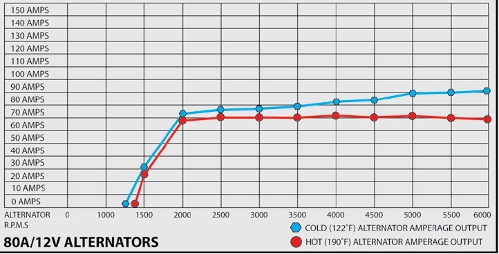

You need to look closely at your alternators rating and your pulley ratio. I have installed a LOT of alternators that are developing near max rating at 1000 to 1200 engine RPM.
The alt below, I have installed quite a few, can achieve a full COLD rated output of 80 amps at 2000 ENGINE RPM if you have a 3:1 ratio. Cold ratings don't last for long though so the HOT rating is what you want to use and look at. HOT rated is a flat graph from 2000 ALTERNATOR RPM to 6000....
That means this alternator is at MAX hot rated output at 2000 ALTERNATOR RPM. That is 666 ENGINE RPM at a 3:1 ratio and only 800 ENGINE RPM at a 2.5:1 ratio. Hardly anywhere near full throttle.
You need to look at the alts hot rating, your pulley ratio and the alts output curve. There are LOTS of alts that are capable if supplying the max hot rated capacity at idle or just slightly above. Most current alternators, supplied by most engine makers, will be hitting well over their maximum hot rating at well below cruise RPM. Many after market alternators can hit their max rating at or slightly above idle speed with a 2.5:1 or 3:1 ratio which are fairly common pulley ratios..
This is a common US made aftermarket alternator by Balmar. (notice this is ALTERNATOR RPM not engine)
Even stock alternators like the Yanmar/Hitachi 60A alternator on the YM series is achieving its rated output at 5000 ALTERNATOR RPM. With a 3:1 pulley ratio you are developing the full rated output by 1666 engien RPM. Even at a 2.5:1 ratio you are hitting full output at just 2000 RPM which is well within cruise RPM range for that engine which has an upper limit of about 3000 RPM cruise and 3600 max.
At just 3100 ALTERNATOR RPM the curve crosses the 50A mark. This is just 1033 ENGINE RPM @ 3:1, basically just a touch above idle speed, for nearly 84% of its rated output for a basic stock alternator..
As you'll obviously know, alternator output curves vary and not all have such a flat curve as the one you've chosen to show. If you'd used the 110A Balmar instead, the curve looks rather different...
My boat uses a Prestolite Leece-Neville 90A unit, and the curve is rather steeper for that alternator, with max output being approached at 4000-5000 alternator revs (like the 110A Balmar above), as shown here...
The Balmar alternator you mentioned uses a 2.7" pulley. Many small boat diesels have quite small crankshaft pulleys - the one on my Volvo Penta is only about 5.2" diameter, so a 2:1 ratio is about the best achievable. Using a smaller alternator pulley to try to get 3:1 pulley ratio can be problematical with higher output alternators due to insufficient belt wrap distance.
Achieving a 3:1 pulley ratio with higher output alternators can be problematical due to insufficient belt wrap distance.
And that 110 Balmar is within about 5 amps of it's max hot rating of just 90A at about 1600 engine RPM using a 2.5:1 pulley ratio. A 3:1, as many engines have, you are at 1333 RPM. At 2:1 your at 2000 engine RPM. I still don't see "significantly lower" than its max hot rating and we're nowhere near "max revs". For many alts you can comfortably get the vast majority of the hot rated amps out of them at or below cruise RPM.
I have installed a boat load of those those 8MR series alts, great units, and also convert them often to external regulation of use with AGM or gel batteries. Leece-Neville builds Balmar's alternators. Most of these installations have been on 2.1:1 - 3:1 pulley ratios and never once had a problem even on AGM's which can really load up the alt. Many of these boats also turn a water pump with the alt belt which also minimizes belt wrap. I don't like it but it is what it is and they usually perform fine provided they are properly aligned and a decent quality belt is used. I have owned three 8MR's on my own boats using either the 90 or 105 amp units. Two of these were with external regulation and one with the stock adjustable regulator. I use a 2.5" pulley on the 8MR alts and our current boat has a stock 2.8:1 ratio.
Even at a 2.5:1 these alts are pumping out darn close to full rated capacity at just over 1600 engine RPM, this is a ways off of full max RPM for the engine to see the vast majority of the rating. Even if you use 5000 alt RPM and 2.5:1 you are at just 2000 engine RPM which is well within cruise range for many small aux engines...
