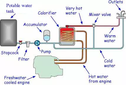

Mixer would be a very good idea, engine heated water gets extremely hot .... mixer valve mixes cold water with the exiting hot water (can even get them thermostatically controlled) and the diagram looks like this ...
I have a thermostatic mixing valve in my shower out only as SWMBO would like hotter water at the gally simk for washinh up dishes.
The other outlets have mixer taps that allow individual mixing of hot and cold waiter as does my outdoor shower
You can have both, just set the clorifier one higher to stop potentially scalding someone as 60 degree water is rather hot

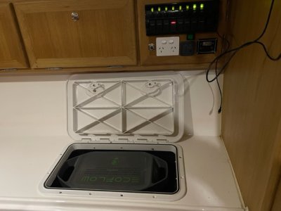

Just a thought on an alternative to many solutions outlined here.
We have a 22litre 240v marine electric storage hot water service which we power via solar panels through a portable EcoFlow lithium power bank which is hooked into our shore power supply line with a change over switch.
This gives us shore power like 240v whilst remote cruising.
We cook via induction and have separate 12/240v compressor fridge and freezer which we power via the units 12v outlet saving the inverter losses.
Yes we have fitted a significant solar array but it means if we limit our engine use we can stay out a significant time without resupply.
The yacht still has its regular house and engine agm batteries for normal yachting systems and lighting limiting any rewiring needs.
The drop in portable lithium power banks are just hooked through the yachts shore power system with the main additional wiring just being bringing extra solar feed wires down to it.
When the outboard is in use any surplus alternator power is also feed into the powerbank units.
Mid winter we can carry a portable gas generator but in the more more usual sunnier sailing times we generate enough solar to leave this behind.
The extra bonus of our solution is the lithium powerbank easily removes for both use in our motorhome style slide on truck camper and also does duty at home as our solar charged power source for our electrically pumped house water supply. IMG_5909.jpeg
oh wow - thanks Grith for sharing that and an interesting alternative solution, especially as I do already have a portable Poweroak/Bluetti 2kw power bank that has 2kw sinewave and solar charger/inverter/12v/240 options. I'll do more research based on yoursuggestions too.

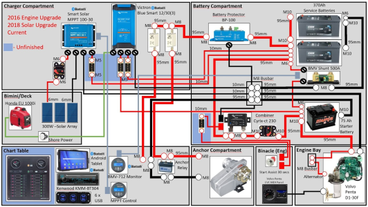

If I were you I'd do an energy calculation based on your electrical system, water usage etc. before spending large amounts of money on electrical equipment to heat water.
For reference, my electrical system looked like this ... the water heater (not shown) was 40l (either 800W Shore Power or engine cooling water powered) and was not something that ever irritated me. We did not heat water with solar derived electrical energy - almost all our hot water came from running the engine (getting in and out of anchorages) - and we boiled a kettle of water for washing up when necessary. I would not fit a gas water heater on a boat but that is a personal choice.
