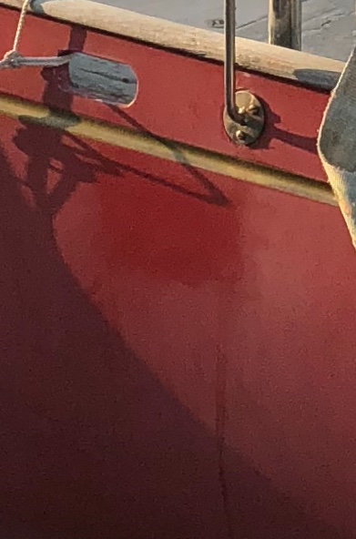

The GRP topsides of the new-to-me boat are said to have been "Awlgripped" six years ago. The colour (red) has faded but seems to come back with a quick polish, as here:
However there are a couple of bare patches which look like parking scrapes. What do I touch them in with?

You can touch in the scrapes with anything. Bear in mind the red will likely have faded, so the touch-up won't match.
But any one-tin paint will have to be fully removed should you ever get the boat repainted in 2 pack paint.
If it is Awlgrip it will probably stand rubbing with 3M cleaner wax or similar, probably best hand applied; even easier though I have reservations about it, is a paint reviver like 'Polytrol' which is basically an oil which applied to the surface brings back the pigment color, there are other makes sold for reviving faded car paintwork.
It might postpone a repaint for 4 or five years?

There's Awlgrip and Awlcraft. 2 products from the same stable, now owned by Akzo Nobel. Awlgrip is harder, lasts longer but more difficult to repair. Awlcraft softer, less durable but far easier to repair. I had my boat done in Awlgrip last winter and was given some touch up in a small tin to use should need it. Not too difficult, but if you have never painted anything it might be tricky. But polishing to get the oxidized red off is a good start. On my white (chosen for not fading as red pigments almost always do), just washing with mild detergent gets it clean.

Thing is, even if you have the correct touch up paint it stands out badly against the faded paintwork, not only is the colour wrong but the new paint exhibits the original gloss.
If you have any artistic bones you may well do a more convincing job mixing up standard gloss paint and flatting it later.
