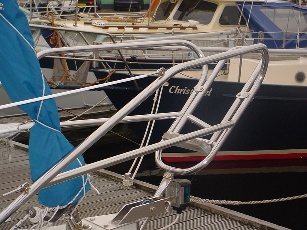

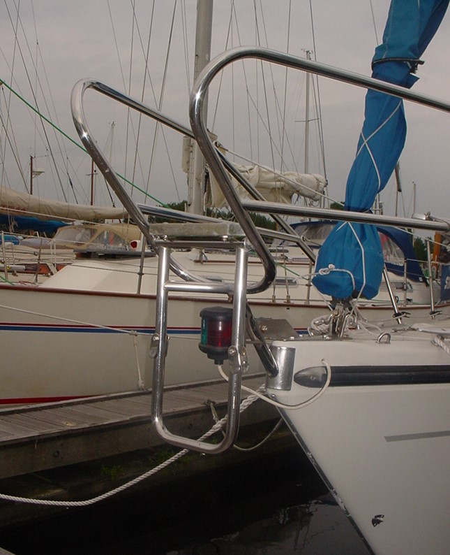

This is my bow/ anchor fittings. I made a step that slots on to my bow fitting in front of my anchors. I can also slot into that step a ladder to allow us to climb over the pulpit on to the step and down the ladder to the jetty in front of the boat.
