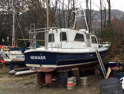

I found a pic I forgot about, it shows the rudder.
