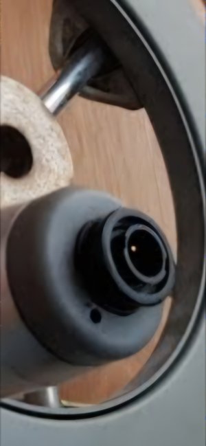

On inspecting my wheel pilot i have discovered the end of motor casing - where the plug attaches is hanging loose from wires.
It appears to have two screw/bolt holes in end but no sign of any screw/bolts in them and no sign of them in binicle below.
Wheelpilot working perfectly well but I need to reattach end ... so does any one know the size of the screw bolts?
I've taped it to stop it swinging on wires for now.
The size looks around M4 or M5 and possibly 20/25mm ???

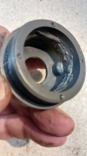

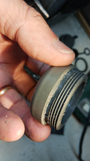

Those are not holes for screws but for a spanner to remove the end cap. The end cap screws into the metal tube. Mine also broke where it enters the tube. The part can be replaced but I repaired mine with epoxy. 1000075281.jpg1000075280.jpg
Those are not holes for screws but for a spanner to remove the end cap. The end cap screws into the metal tube. Mine also broke where it enters the tube. The part can be replaced but I repaired mine with epoxy. View attachment 185808View attachment 185809
Thanks, I'll extract and take a look, its sheared off in exactly same place as your image. I'll order new one I think.
