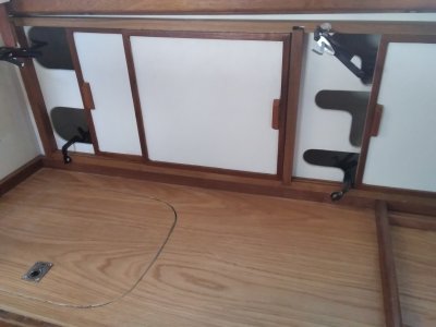

3mm is not stable enough to be a stock size. 6mm is the common one for teak, but few people stock that either although Howells have 18*6mm radiused capping.
Band saw is a good investment if you do a lot. I have cut all sorts of sections including cappings for my current refit project including many metres of 12*4mm in iroko for framing sliding doors in the galley. The timber was a stair handrail over 50 years old and removed from my house 30 years ago!
