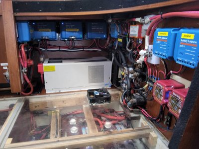

I installed my inverter behind the seat backs. The cupboard has two large vents in the top. Two large vents in the bottom open to the bilge and 3 computer ventilation fans running 24/7. It's quite a big space and houses all my kit very close to the batteries with super easy access. Th inverter is screwed down to the shelfreceived_203949902590247.jpeg
