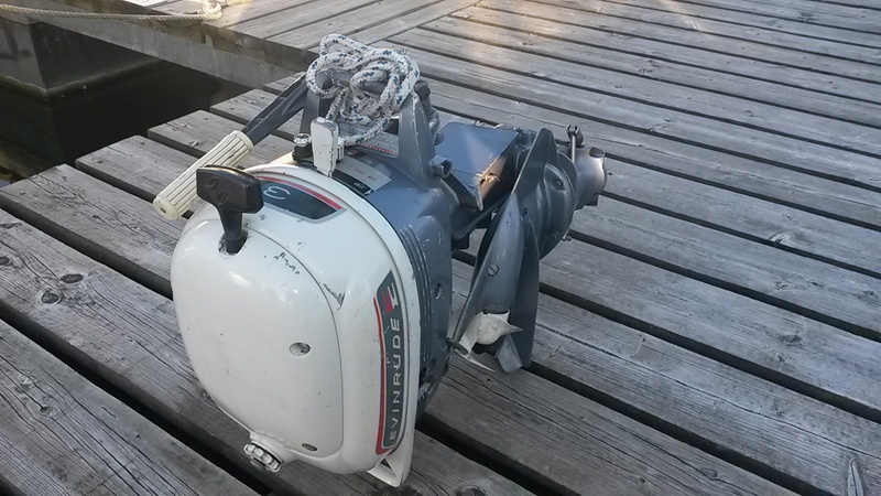

My little outboard was made in 1966 and still working - not that all things built in the 60's were necessarily made to last.
Here it is with it leg folded - which is very handy .
