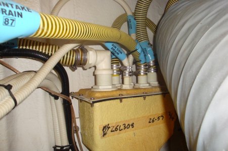

A few years ago, we did some work on the exhausts that meant removing the silencers and this was what we found behind:-
Simple fix whilst that silencers was out but it taught me a lesson - keep those covers/filters in place.

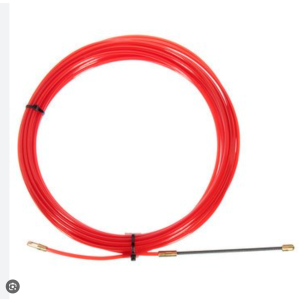

I personally use a electric cable puller, pushing through the skin fitting outlet. The blockage is usually very close to this outlet due to the 90 degree skin fitting used.
Pic below shows an example of the cable puller.

Thanks to Tico for raising this issue and for all other(s) advice. I have used a cable puller (draw cable) from the top, but found it hard to wiggle around elbow from outside skin fitting (could be because blockage is there of course which is logical) may revert to trying again from there also try some HP air, elbow absorbs most of the energy from a wet pressure washer.

Unfortunately I've found the only way to successfully clear a blockage was by pushing the cable puller through the skin fitting outlet on the hull. Trying it the other way, from the flybridge drain, resulted in the cable puller getting stuck / hitting the skin fitting 90 degree bend as you've unfortunately discovered.
