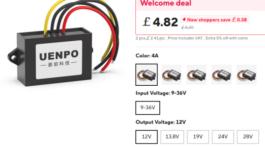

Just bought one to give me 12v (new lithium seems to spend it's time at 14v) and misread 15v to 40v input as 5v to 40v. Slight difference.
Will it work or do I need something else?
Probably not, but it depends on the type of regulator. If it is a simple linear regulator the input will need to be at least a volt or so above the output so it will not work with 12v input. Other switching units might possibly work but the only way to know is to give it a go. Try putting 12v or less on the input and see what voltage comes out when you draw a typical load.
The correct ones are available:
He already has 14 Volts from his Li. at the input. :oops:
No idea what he wants it for but just going by his post it will probably be OK. Try it and see:giggle:

Not withstanding post #6, i have used (on my own boats only) a few of the ones below with things of low value, such as LED strip lights, and they have always been OK. I did try one on my last boat with a cheap TV and it was also fine.
Anything of value, such as electronics, i'd use Victron.
