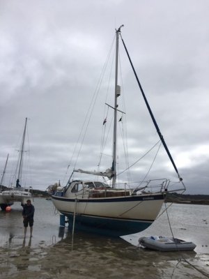

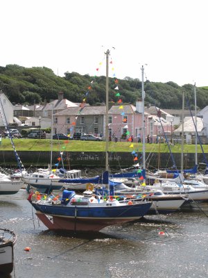

Sorry not going to be a great help on the Bristol Channel as have only sailed in that area a couple of times, on a friends bilge Keeler, but I did sail a long Keeler with Yacht Legs on the West Coast of Wales for about 22 years, (Invicta 26) with its home mooring in the drying harbour of Aberaeron in all weathers, (see images) and in that time have moored in various drying harbours including Porthmadog harbour, Cardigan, Solva and Tenby.
If the legs are from the Yacht Leg company then they will meet the criteria suggested by Graham Wright in #7, but don't worry too much about mud as long as the bottom is fairly level, but of course this applies to a bilge Keeler as well.
Looking at the current state of Watchet it may be sensible to avoid the pontoons and go against the harbour wall.

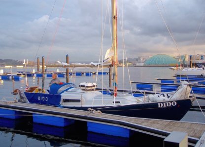

Hi Allan
Yes it was Dido, lovely boat, I saw a photo of her a couple of years ago and she looked a bit sorry for herself.
Dido in La Caruna a few years before I sold her.

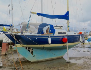

+1 for yacht leg company legs - I bought mine off a certain v c of this forum and they have enabled me to dry my long keeler out in many spots. Makes up for having to sell my bilge keeler which I thought better suited to the Bristol Channel - but I am now away in better cruising grounds with only Scilly as the common point
