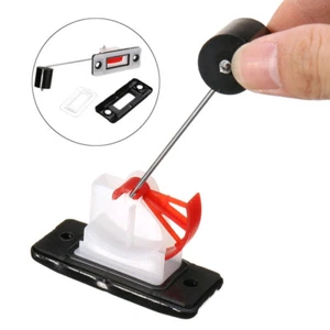

No ... like these :
generator tank fuel indicator for sale | eBay

"Gixer" ... what ever sender you get - make sure you get matching meter to sender .. there are USA and Rest of World versions !!
The Sender I linked to is a complete set ... but you can get similar to Vyv's and also the magnet ring type where a ring rises a vertical tube ...... all good ... and can be found with very shallow heads that just bolt to the tank once opening cut.
There are even 90 deg bent versions - so you cut hole near top of tank at side and insert there ....

Thanks vyv and refueler, This is similar to what I fitted to my fuel tank. that one does protrude a but more than I like but I'll have another look for a less obtrusive one.
