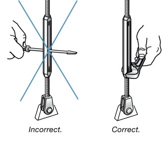

I've was going to suggest the recommended way to turn the rigging screw is a spanner across the centre rather than through the middle..
Selden guide..
Although I did also notice your upper split pin is still in place in the photos.
Yes, I realised afterwards that I should probably try that tomorrow, as the spanner has more strength when used in the correct direction.
