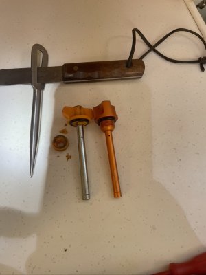

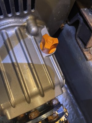

And astonishingly, if they are similar to the one for a 3GM, the plastic they use for the top is attacked by gear oil! When I saw their price I made do with a bodged up repair
Yanmar's dipstick is, as Vic says, soft rubbish and tends to keep breaking.
Cariblue Marine do very nice alloy replacements with the proper vent hole etc. Having extracted the remains of my (inherited) gearbox dipstick I used one of these and am pleased with it - also very nice to deal with.
