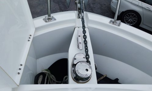

I've taken on-board (excuse the pun) the advice and put a deposit on a 2016 model 695 with Yamaha 175hp. The boat has most of the extras I need (windlass, thruster etc), but will still require a few things adding. I'm not bothered about the lack of a full aft enclosure; I had one on the previous boat but put it in a locker where it stayed for the 5 years I owned it! I also stored the aft sun pad infill table and cushion etc at home as it just seemed to be more clutter that was rarely used. Horses for courses and all that!
One thing I do need is some means of attaching the mooring rope. The boat will be kept on a swinging mooring and there is no cleat in the forward anchor/chain locker. The factory fit windlass support crosses over the usual position. I'm wondering if I can fit a cleat on the support, at the side of the chain position where it won't foul. Obviously, when the boat is on the mooring the anchor will be temporarily shifted off the bow roller and stowed in the locker, with the mooring strop taking its place.
@Catspaw I'm facing exactly the same design issue on my 2017 MF 695 Marlin. What did you do in the end? Any photos available? I want to fit a mooring bollard / samson post if possible... I'm going out to her today to measure up to see if there's enough room under the anchor locker hatch.

Probably a bit late to reply now, but only just spotted your question.
In my case I simply fitted a suitable stainless cleat on the windlass support, a couple of centimetres to port of the anchor chain position. The windlass support was strengthened with some fibreglass matting on the underside, plus a 316 stainless plate to spread the load. Strengthening probably wasn't necessary as the windlass support is designed to 'hold' the boat, but as the boat is on the mooring in all weathers I thought it might be a good idea. The system has worked perfectly for over 4 seasons, although the downside is having to stow the anchor in the locker every time before attaching the mooring line. I also remove the tilting piece in the bow roller fitting before mooring (and swap over the plastic roller from the tilting piece). This is a faff, but I don't want to strain the bow fitting while on a swinging mooring. I also made a plastic cover to protect the cleat from scratching by the chain when hauling or deploying, but found this wasn't really necessary. Hope this helps.
Oh thank you so much for your really detailed reply and photo! I am going to copycat exactly what you did, that looks great! I’m also on a swing mooring all year round and agree with the extra matting and steel plate to spread the road. The windlass support may hold the boat but the windlass itself has a wider surface area with more fixing points so is less likely to tear through than a cleat with 2 close screw mounts. It looks just the job. My only reservation is that it limits the guage of the rope much lower than a Samson post / mooring bollard… but as I saw when I went to measure up, there really just isn’t a choice, it’s impossible to fit one. I haven’t been able to find many design flaws at all in the MF 695 but this is definitely one of them! Other than that I hate the windscreen wipers and there is no drainage hole from the forecabin into the bilges. Otherwise I have zero complaints!
