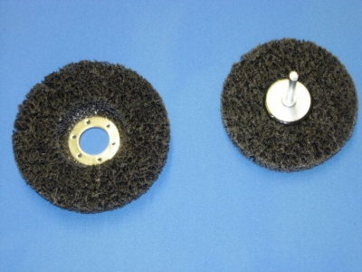

Hawk House sell these "face off " discs for glue removal.
I tried something similar but did not find it effective
I eventually decided that what could not be removed easily could stay!
