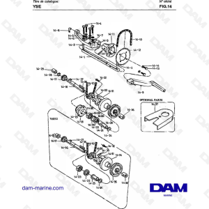

Behind the bottom sprocket there is a housing (14-31. )
In this housing there are three balls (14-35 I think)
When you rotate the starting handle the balls centrifugally throw out and engage.
If you lock the upper shaft with the locking screw (14-5) the balls should disengage and the whole unit will not rotate.
If dirt or gunk gets in there, the balls sometimes don't disengage, Even one ball will keep the shaft rotating.
As Cptn Hornbag has suggested, Spay some WD 40 in behind the lower sprocket to wash out the dirt, add a few drops of oil and use the locking screw and you should be back in business.
