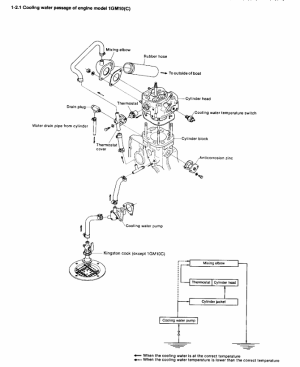

This diagram, from the workshop manual , shows the cooling water system and flow paths.
( the sub-diagram that shows the flow path is however rather misleading in that it appears to show two inlets to the mixing elbow when, in fact, they are combined into just one hose from the thermostat cover to the elbow. )
