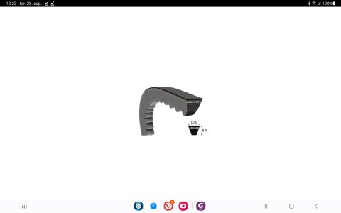

Well the 10 x 1000 fitted ok, but I'd like to find the exact measurements of the original parts. But having said that the ones I had as spare were supposed to be the correct size but aftermarket. So maybe I do have an upgraded alternator. Will any 10 x 1000 work or is it a specific tooth shape?

We have a Yanmar 4JH4-HTE in our motorsailer.
We had serious trouble early on in our ownership with lots of adjusting needed plus lots of black rubber dust. The boat has a 110 Amp Balmar with smart regulator with 'soft start' function.
Changing to a genuine Gates notched belt has completely fixed it. The notches on the inside run allow the belt to be tighter around the small alternator pulley. Bending to the same radius as the alternator pulley by hand, an OE Yanmar belt at almost three times the price, bunched and distorted. As the belt drives on the sides of the vee pulleys, not the bottom, distortion here caused high spots which soon wore away into dust leaving a loose belt.
The current belt on our boat is five seasons old and has not been adjusted for two seasons of mostly motorsailing with the engine at 1200-1800 RPM. It has 20mm slack in the longest run between pulleys. Visual inspection and measurement with a vernier shows it is in good condition and has lost barely 0.5mm in width.
A friend with the same boat was advised to fit the serpentine belt kit with grooved pulleys. He did so at some expense but has no better performance than us.
After the early problems with genuine Yanmar belts I purchased 5 Gates notched belts.
