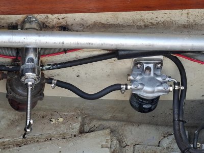

Job all done now with a nice dry no leaks spin on filter, great result thanks for all the input and links folks.
Always great full for great info and help with problems which seem to surface now snd then.👍

Just an update on my previous photo.
I replaced the standard problematic cav standard 2 sealing ring filter version (which has a tendancy to leak) with a cav spin on conversion unit, which is no different from the racor type spin on unit, but considerably cheaper. Also has the benefit of not having to replace all the original fittings, although I did just fof piece of mind.
