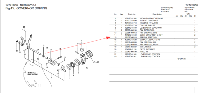

RE; Pete's post.
I put my finger in the oil filler hole in the front of the engine and poked around under the injection pump, I felt a spring suddenly return as I touched it,
That is very interesting as that spring in the parts manual is identified as SPRING, STARTING.
That is the rack setting in the oil filler hole. Usually only gets out of position when it has been assembled wrong. worth a look as it may have jumped. Having had every bit of that in my hand, I still could not figure how it gave extra fuel when starting as there is no throttle to speak of. I replaced Governor springs with new. I start my 1gm 10 with no throttle, and only use decompressor lever to spin up oil pressure.

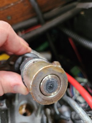

I pulled the injector today and found this so I'll get that looked at and see what's what. No joy poking around the governor so sadly not that simple a fix. I'll try the valve clearance next if the injector doesn't do it1000066583.jpg
