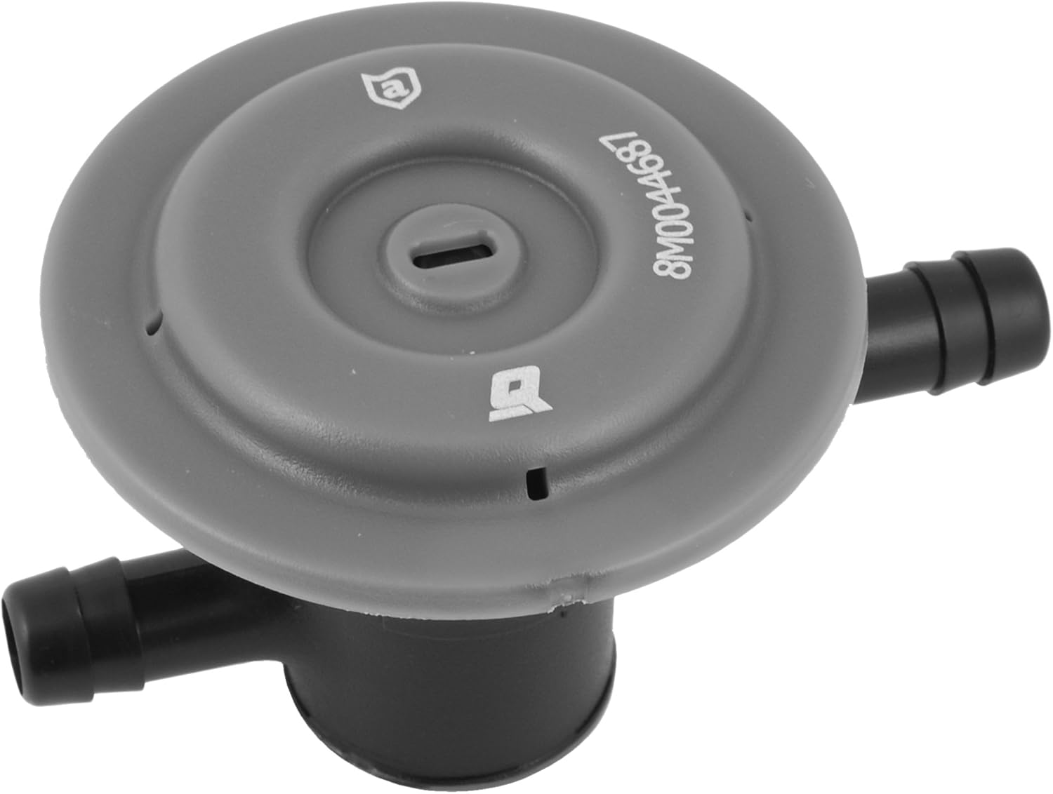

^^ This can happen, specifically with the new non-vented tanks. In the US, at least, a pressure/demand valve is available. A simple valve works.
However, since the OP is not having this problem with cold start, this is a different problem.
