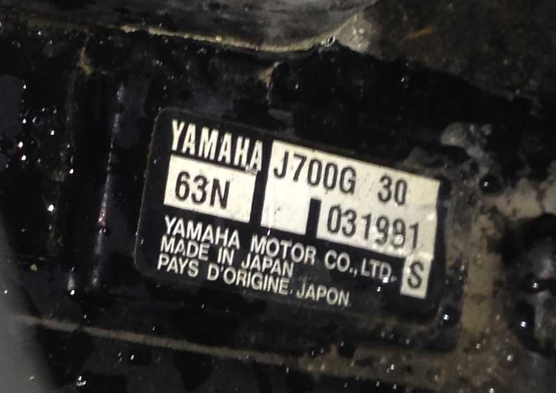

engine sticker says 1YMXM-7013CB
only got a pic with the top of the engine atm:
EDIT: OK, looking around I found another sticker J700G
I understand that means the 700cc one, correct?

Sorry it’s takem so long. Yes. Instantly recognisable as the 700cc yam 2 stroke.
Also world renowned as one of the most reliable 2 stroke engines out there.
Look up the manual for a “Yamaha waverunner xl700 or xlt700”
