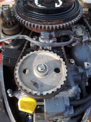

We have an Yam 4 stroke 8HP OB that came with our new to us boat this season. It runs fine and has been reliable.
But I notice it uses a toothed timing belt. I don't know the age of the engine or it's service history, so like you do on a car, should I be changing this timing belt as part of the service this year?
The engine details, anyone got any idea of the age from that?
And the timing belt with the covers off
It looks pretty crude, no sign of a belt tensioner, and it looks like the flywheel would need to be pulled to change the belt.
Any advice please?
For me, I'd change it. It's possible that penetrating oil might be needed to loosen some stuff, and you've got time on your side to reduce the stress of any unforeseen stuff.
That's my gut feeling if it is not too difficult. Even if a snapped belt did not destroy the engine, it could spoil your day on the water.
But I wonder what the official service interval is? Though of course I have no clue when, if ever, it was last changed.
I am also keen to hear from anyone that has done it. If I pull the flywheel, am I safe to assume the crankshaft pulley for the belt will remain on the crankshaft, i.e. it won't come off with the flywheel?

It looks reasonably straightforward except that the hose on the thermostat housing will have to be removed ( that'll probably mean removing the housing but at least you'll then have access to the thermostat.)
Use the correct type of puller to remove the flywheel. When you reassemble be sure to refit it to a clean taper and torque the retaining nut correctly.
The belt drive gear is separately retained, and keyed, on the crankshaft under the flywheel so no problem there.
Put some timing marks on the camshaft gear and the flywheel before you start and on the belt drive gear after removing the flywheel.
The blue mark on the camshaft gear suggests someone has changed the belt previously. Maybe you'll be able to use the existing marks

Thanks that is very useful. There are two timing marks on the camshaft pulley and I would guess there are also timing marks on crankshaft pulley when it is revealed.
What do you mean by the proper puller? I have a unuversal puller set that basically has a collection of different legs of different lengths. If sets up as 3 legs that go under the pulley and then you tighten the centre bold down on the shaft. Is that what you mean?
That hose that i have already determined would be in the way. so that is the thermostat under that housing? As I had been advised to replace the thermostat, I presume I need a new thermostat and a new gasket for the thermostat cover then? And if removing the thermostat housing no need to disconnect the hose?
The correct puller is known as a "harmonic balancer puller". It bolts on to the flywheel with three high tensile bolts. A 3 legged gear puller is likely to damage the flywheel.
It is often difficult to pull the flywheel off.

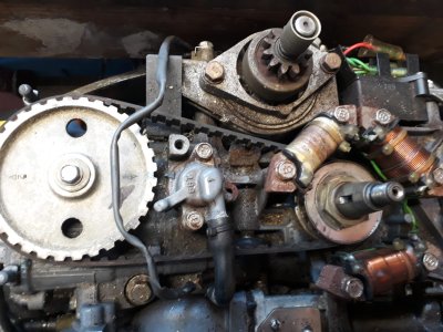

I have taken the flywheel off this morning, it came off quite easily with my normal 3 leg puller without damage.
Changing the belt looks easy. The timing marks on both pulleys are clear. One magneto coil will have to come off and the thermostat housing, I want to replace the thermostat anyway.
so before i proceed I need to find a UK supplier of the timing belt, the thermostat, and a gasket for the thermostat housing.
Mark the position of the coil so that it can be refitted with the correct clearance between the polepieces and the flywheel.
Clean the mating surfaces of the taper and dont forget to refit the key in the crankshaft before you refit the flywheel.

Just to confirm that I changed the belt and thermostat on Sunday and this morning put the OB in the tank and ran it. All good.
It was really quite a simple job. I searched for the belt on the belt part number rather than engine type. Total cost just under £50 for belt, thermostat and gasket.
