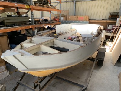

How it's spent most of the last 35 years. As a storage box in the shed at home.
And now it's in the back shed at work, empty and ready to be restored. (Grandpa pushed the windscreen back quite a bit and did a different side window shape).

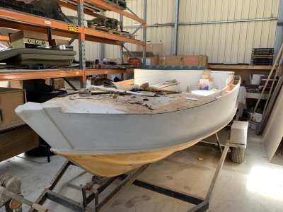

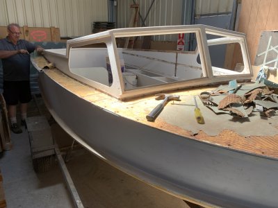

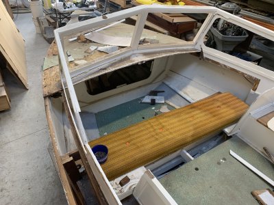

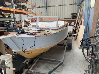

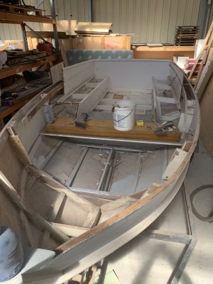

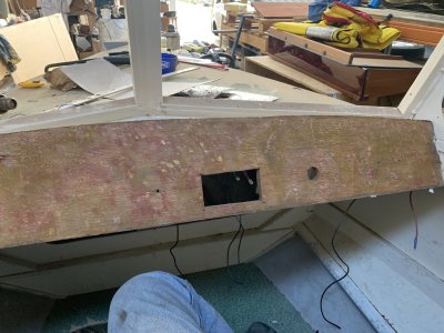

And dad and I have finally started to dig into the boat. Deck is off, windscreen frame and dash are out.
We'd love to find some more of the no slip decking that was used originally, if anyone knows of a similar product that's still available.

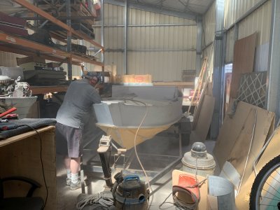

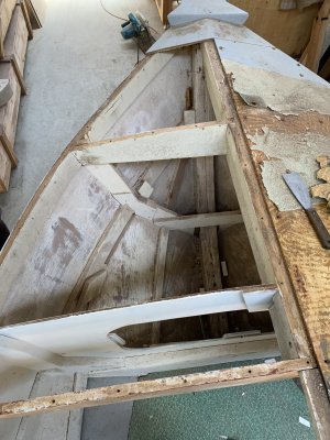

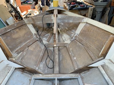

And splitting this off as a second post.
Dad decided to grit blast most of the paint out of the bow. The old glue hasn't help up the best, that said I doubt they expected them to last 50+ years.
There's some old rot in the stem that will be filled with glue, we're also starting to re glue all the little pieces back together.
