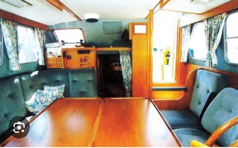

When I made a shortlist some time ago, easy entry to the cabin was important. In practice I spend a lot of time popping in and out of the cabin and am glad its a few easy steps, not a ladder. Especially when carrying a drink or food. In calm seas no hands are needed. When rough there is plenty to hold or wedge against. Screenshot_20240114_211404_Google.jpgThere are sacrifices to interior volume, and I have made a washboard to raise the sill in wild conditions.
I think it's about how you use the boat underway, at anchor or moored. If like me you want easy access then look for designs that offer it.
The Moody 42 is a great big volume cruiser but I would find that ladder journey a chore.
