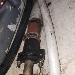

If I was surveying the boat I agree with Dansaskip that rubber stern seal looks very thin and maybe not even the right type, Stern tube rubbers are thick and made to a shore hardness specification try here Stuffing Box Hose
Stern gland packing comes in different sizes. You need to measure the distance between the shaft and the inside curve of the housing body to give you the correct size for the packing.
