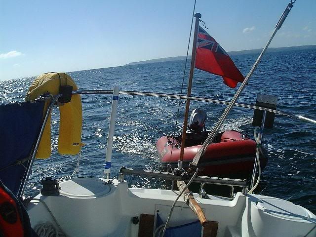

Yes, I have a Seamaster Sailer 23. I think rainwater runs down the tiller and into the joint with the rudder stock which eventually causes it to rot.
After I got the new cheeks made I used the Burgess stuff - the name eludes me (top gloss?) which was water based but faded, and turned opaque. So I just painted over it with Toplac (white gloss). I suspect varnish lifting on a good well prepared substrate seems to have more to do with varnish thickness, as the bits with +5 coats seems to last in my experience. Not quite sure why though!!!
If you have a Sailer 23, I am interested in the mainsheet traveller, as I just have the horse over the tiller, and wondered how the mainsheet block position could be controlled whilst underway
