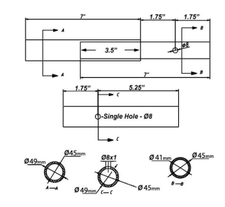

Duckworks. The below are for kayak paddles, but they sell others for oars. Not cheap, but first quality.
Carbon Fiber Ferrules for Oars or pushpoles

There is a Tinker Owners association who may be able to help. I would probably go with aluminium tube
rogerthebodger
3 Nov 2001
13,799
If you get a 38 mm stainless nipple you will find that the I/D is close to 40 mm, and you can join the oars together. You could also screw then together using a stainless-steel socket in the 2 nipples

You could try stainless exhaust suppliers. They will have those sort of sizes and may be able flare the tube to make a joint. They are used to manufacturing one offs for sports cars and specials and will have all the required tooling.
