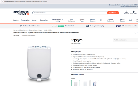

It's a Meaco dd8L
... Note that dehumidifiers have a reputation for catching fire.
The ones with a slight risk of that are the compressor dehumidifiers. Desiccant ones like the Meaco above operate in a completely different way and pose no risk. Or at least, no more risk than any other piece of electrical equipment you might have on a boat.

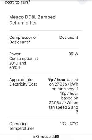

A perfect answer as usual with superb evidence produced.
Very informative.
Very interesting too; they obviously heat the crystals to dry them and that hot wet air is condensed and collected into a container which when full turns the machine off.
Interesting engineering going on in there;
The hot air to dry the crystals is presumably separated from the moist warm air in the boat holding the water vapour that impinges upon the dry absorbing crystals.
I wouldn’t want to engineer that.
Grateful for the excellent answer.

Interesting costs (if correct).
Once the set humidity has been achieved the machine cuts in only when required. I use the lowest power setting and the least demanding humidity setting and that's sufficient.
Based on previous years I expect it will be £90 or so in electricity over the winter.
