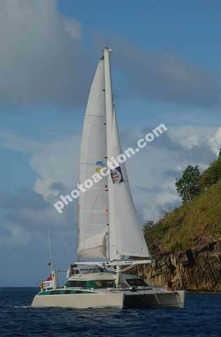

Re: Wing Sail on a Morrelli &amp; Melvin
Here is my rig. As you can see, the wing represents about 15% of the total area.
As the wind strength increases the wing plays a greater part until at gale force it is the only thing left. I have done 9 knots on a reach under mast alone.
I would not consider any larger area of <u>permanent</u> wing area for the reasons I have described previously. I believe that a full wing that can't be reduced in area is not a seamanlike rig for long-distance sailing.
I can see the point of such a rig for speed record attempts and I can see that it would have the same sort of efficiency gains over mine that mine has over stayed pole masts but for cruising? No way.
