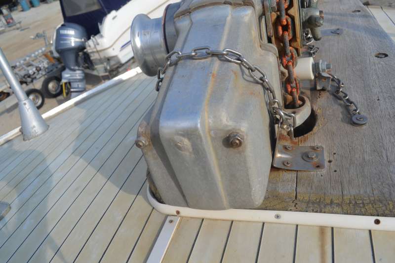

I did post a few pics from the boat I'm considering atm a couple of days ago.
One of the things I noticed is that the windlass does seem to have a small crack in its body, assuming at the one end of the main axle running through it.
I've not tried operating it yet, will do on second viewing on Friday, but could anyone speculate if that's okay to live with, or if I should be calculating the cost of a 1.5kw or thereabouts windlass pretty soon (if not repairable) ?

TBH the whole installation looks a bit - well - err dodgy! Still if it works I suppose that is the important thing. Is it the small crack in the casing you are talking about or something else?
Yep, installation is dodgy, will be dismantled and secured properly if sale goes ahead...
And yes, I'm talking about the small crack. I d like to kmow if the cost of a new windlass should be considered and be another price negotiation point.

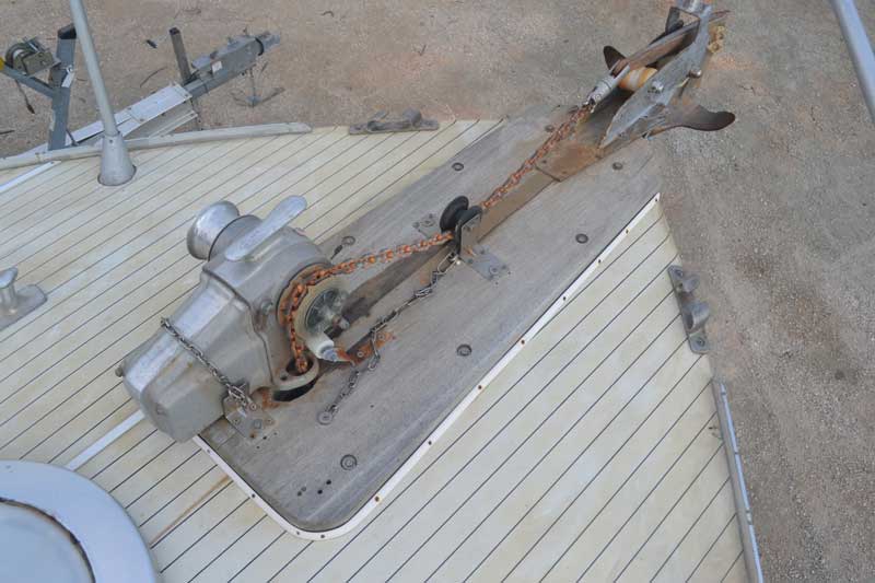

certainly should.. even to install correctly what is there would require some GRP work to the underside I would imagine... looks like its trying to pull itself off the deck and it is just being held on with a few screws...
THE CRACK HAS BEEN CAUSED BY THE ILL FITTING. The wrap over chain and bracket is really "novel", if you look at the hawse hole it is too big and no meat left to fit the windlass properly, would not be surprised if it is not a write off, and if/when refitted the whole thing does'nt implode.
certainly should.. even to install correctly what is there would require some GRP work to the underside I would imagine.........
Wooden boat, so woodwok needed and could be relatively easy to replace the whole piece and supports. Looking at drawings, and experience, you should have good access for repair/replacement. ... but something is needed here....

OK, continuing on the thread, on visiting again the skipper told me that couple of years ago they anchored at around 60m on a rocky bed, took them two hours going around and pulling to remove the anchor and in the process it broke the piece of timber it;s bolted on and pulled out the screws (basically fckd up the whole thing big time) On returning they had to cut the timber (hence how it doesn't protrude much - if any) and secured it this way. There was no shore power on Fri so couldn't see/hear it working though he says it's working fine.

recently I have replaced a bigger but similar winch on my boat,
about your winch,
as far as I can see, the crack's your talking about, are in the cover for the electric motor, this is nothing to worry about. just make sure no water ingress.
this cover is not in its correct position,
but similar to my old and new winch this can be repositioned in the correct place, and at the same time fit a new seal between cover and gearhouse.
with some battery power, you will be able to test the winch,
it will probably need som new gearcase oil and TLC, but expect it to be working, if not, spare parts are available at Lofrance (your model is still existing)
about the fixing of that winch, yes the assembly looks really dodgy,
I would cound in, a replacement of the support of the winch, replace the complete old plank, with a thick, solid piece / plate of wood, so that everything is fixed strong enough, en in the exact position, and with the correct fittings, not a dodgy chain...

You are right mine is still in production by Lofrans Tigress 1200w and indeed the chain securing has messed up with the cover, pushing it down so nothing structural there.
